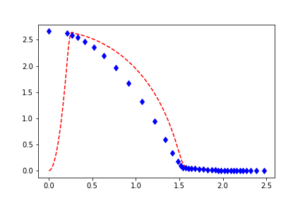

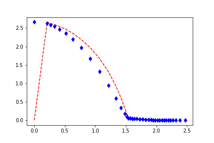

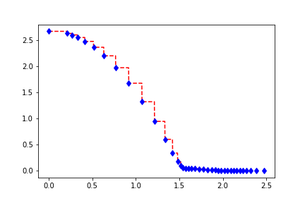

The value of that CF however follows the data not very closely.
I’m setting up the CF like this:
spline = BSpline(n, B_list, mu_list) mu_cf = spline(B_cf)
I put the output value of that CF for different orders compared to the interpolation data in the attachments. Order 1 is mapping the the data in a acceptable way but since I need to differentiate this cf order 1 is out of question.

Order n=1
Order n=2
Order n=3
you have to duplicate the first control point (value of B_list)
then the n=2 B-spline will be linear interpolation.
