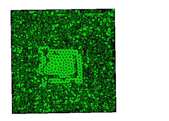

Hello, I am still having this problem. And, it also happens if I am using an STEP File. Can anyone help?

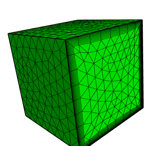

Hi, I tried exporting to other formats with no luck. But saving as a .vol file preserves the boundary layers.
geom = Glue(OCCGeometry('testcase.step').shape.solids)
bl = [2.67e-2]
for i in range(11):
    bl.append(bl[i]*1.1)
bl_p = [netgen.meshing.BoundaryLayerParameters(boundary='default', thickness = bl,
                                               #disable_curving=False,
                                               #grow_edges=False,
                                               limit_growth_vectors=True,
                                               domain=".*",
mesh = geom.GenerateMesh(maxh=0.5, boundary_layers=bl_p)
mesh.ngmesh.Save('test.vol')
Drawing the mesh in ngsolve, I get

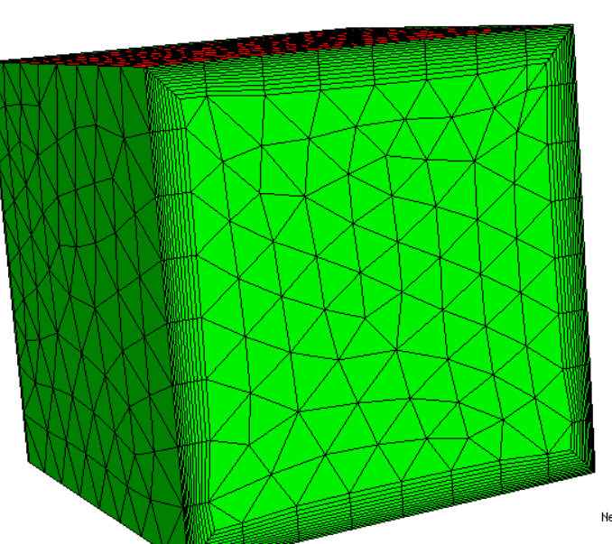

Loading the test.vol file in Netgen, I get
PS: I generated a simple box and saved the step file to test your code.
