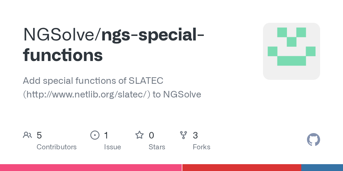

Hi, no you cannot use scipy functions as coefficients, but we have the ngs-special-functions addon that provides these functions:
