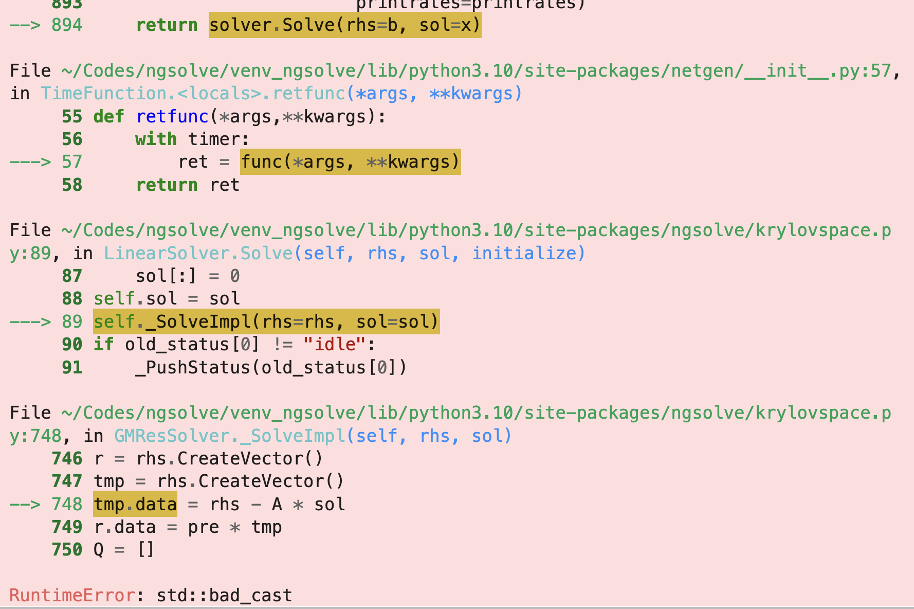

Thanks for your reply. I’m trying to implement a FEM-BEM code, and my A_{1,1},A_{1,2},A_{2,1} blocks are FEM spare matrices and A_{2,2} block is a BEM H-matrix whose subblocks \{A_{2,2}\}_{i,j},i,j=1,2 are standard integral operators. Firstly I defined A_{2,2} as a block matrix, but when I invoke GMRES, it said bad::cast. But I made it though by defining a 4\times 4 huge block matrix…

Here V_mat is a blocked BEM H-matrix, and all others are sparse FEM matrices.
from ngsolve.krylovspace import CG, GMRes
m_id = IdentityMatrix(fesV.ndof, complex=False)
rhs_vec = BlockVector([f_vec,0*f_vec,0*f_vec])
lhs_mat = BlockMatrix([[a1_mat,-a2_mat,None],\
                           [a3_mat,None,-a4_mat],\
                           [None,m_id,V_mat]])
sol_sym = GMRes(A=lhs_mat, b=rhs_vec, pre=pre, tol=1e-8, maxsteps=400, printrates=False)
It seems GMRES only admits a blockmatrix whose blocks are usual basematrices. So it doesn’t work for a nested blockmatrix.
