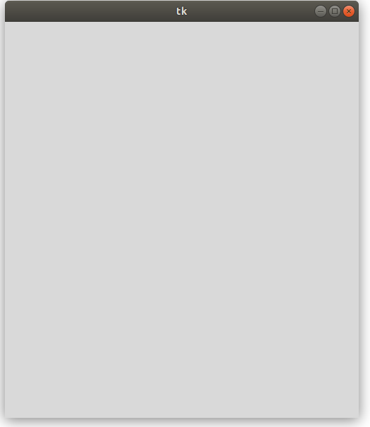

However, the gui is not working properly, it only pops up a window without any information. See attached photo.
https://ngsolve.org/media/kunena/attachments/758/Screenshot from 2020-01-14 15-55-55.png

Hello again, please discard the previous message, after run
python3 -c "import netgen; print(netgen.__file__)"
I realized that it is pointing to an older build from source without GUI.
After a correct environment setup, everything seems working up to now. In particular, the umfpack and pardiso solver are all working nicely.
