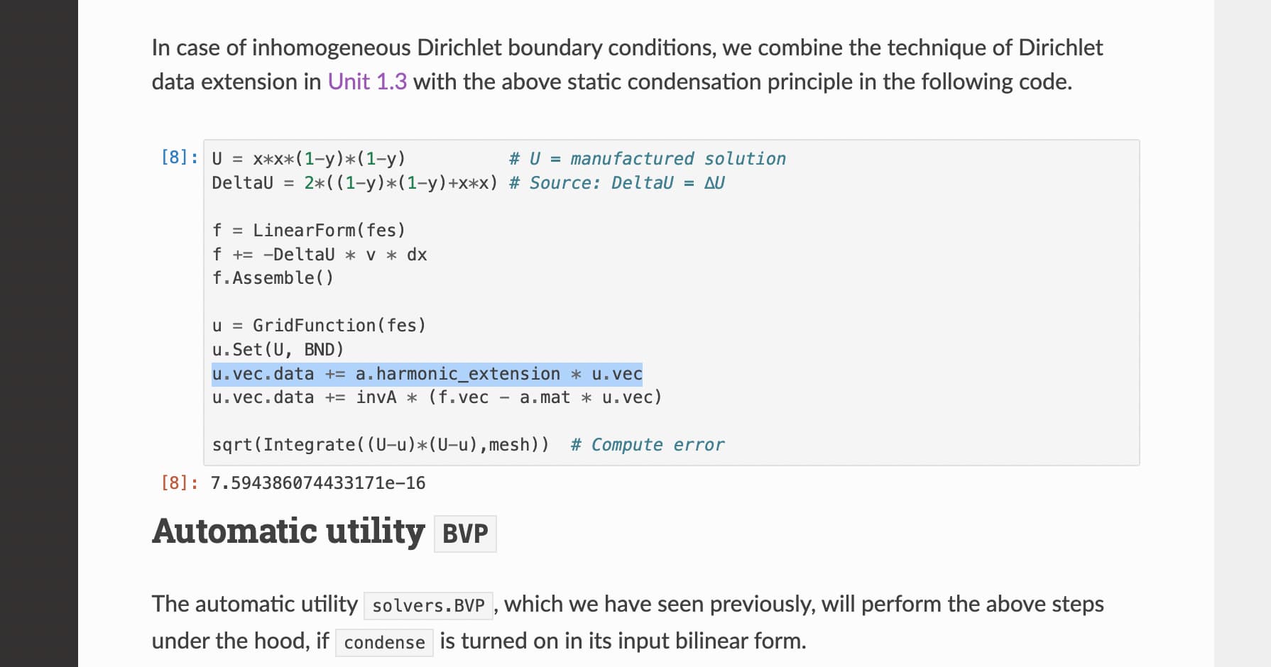

Why do we have the highlight line in the picture? I think it should be deleted.
look at the printed error, with and without this line
also, visualize grad(u) for both cases
read explanation above, note that a.mat is the Schur complement
