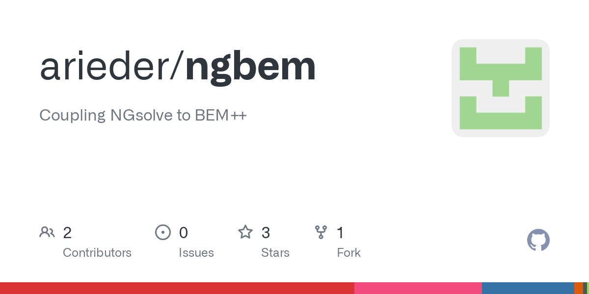

Hi Francis,
Alexander has posted now his (3rd party) coupling-code between BEM++ and NGSolve at github:
We can help with the NGSolve side,
