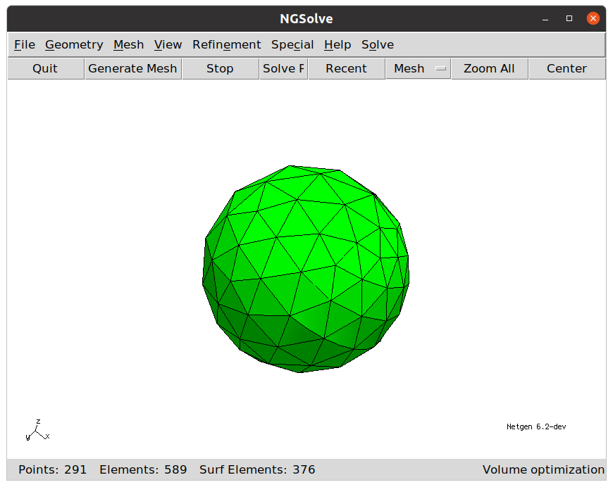

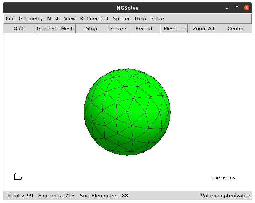

Hi, I’m using mesh.Curve(3) for a sphere. However, when I add a boundary layer in the mesh the Curve function does not improve the mesh. Can you see if I’m using it correctly? I attached images of the mesh with and without the line mesh.BoundaryLayer(“.*”, [0.01, 0.02], material=“mat”, domains=“mat”)

In this case adding disable_curving=False to the boundarylayer parameters should do the trick. But note that the curvature is not propagated into the layer so on convex surfaces this could lead to push through elements on not fine enough meshes (thats why we disable it by default)
