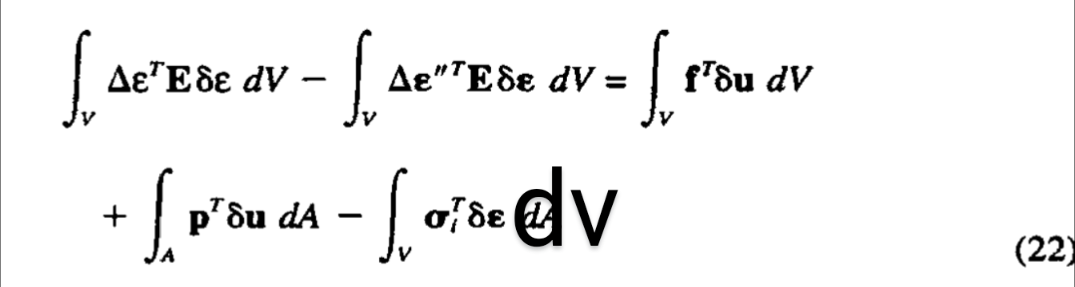

Hi Gonzalo
Sorry for my late reply. I got some problems and couldn’t respond. I am actually trying to solve linear viscoelastic problem. I have attached my variation form. My problem is ∆e" has initial value and should be a tensor of 3x3 (similar to elastic strain). Is that correct to use Hdivdiv space for ∆e"?
