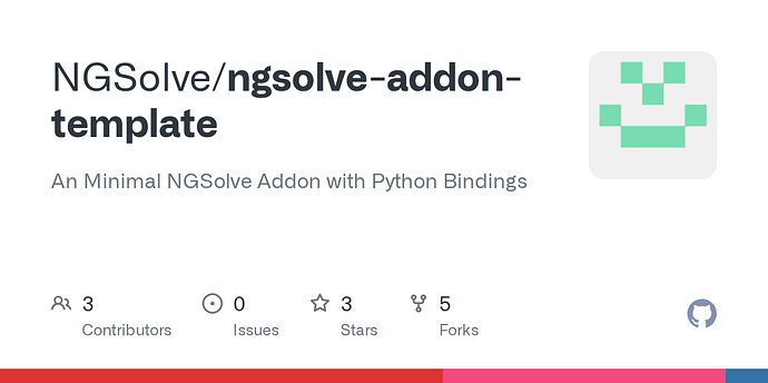

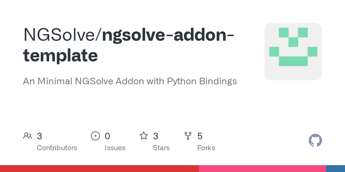

I don’t think such a space is implemented currently, but should be fairly easy in a cpp extension.
you can take this as a starting point:
and have a look at the implementation of the nonconforming space. a nonconforming surface space should be quite straightforward using the existing nctrig1, …
best
Thank you for your suggestion; it is very helpful. I’ll take a look at the implementation of the nonconforming space.
