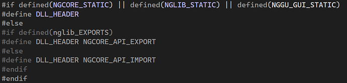

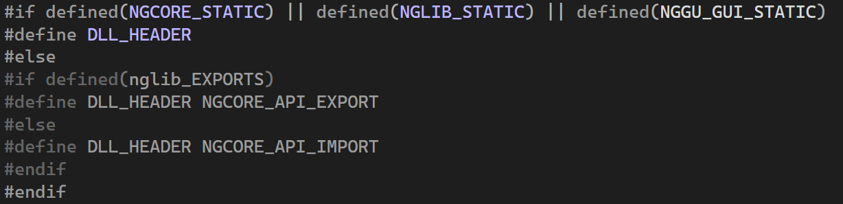

(1) to change the ngcore and nglib from shared to static, set the DLL_HEADER to empty.

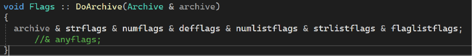

(2) to turn the use_python off, delete the anyflags in function Flags:: DoArchive.
