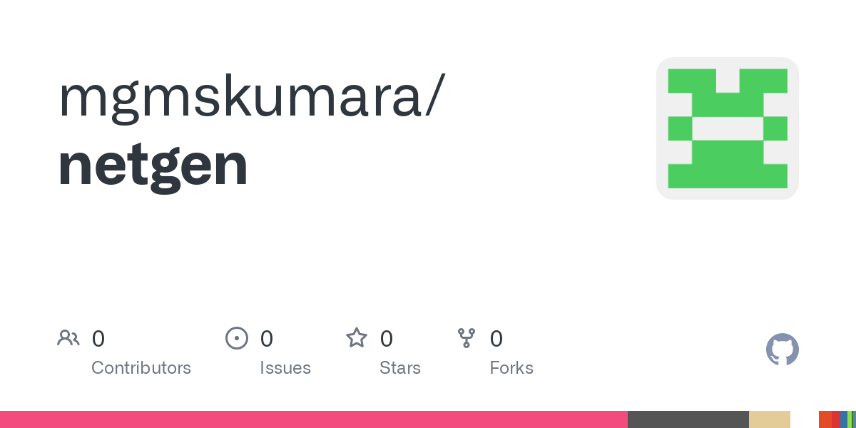

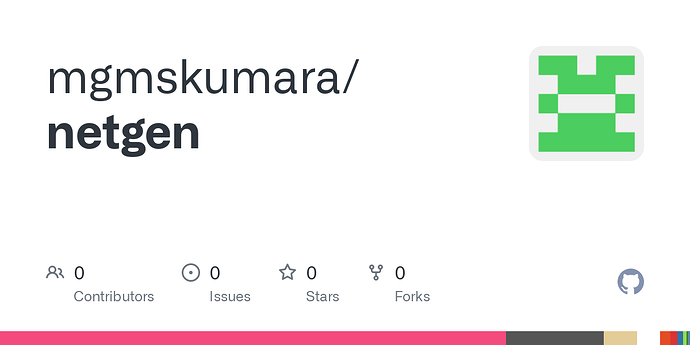

I tried to submit, but i couldnt do that because i dont have much knowledge on github
please check these two
fix is in this file
If you cant get resolve, please comment here
