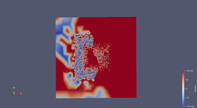

At baa43, however, the result is
In non-MPI mode everything is still fine.
