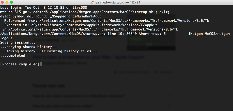

Today i had to setup new installation of Netgen/NGSolve on macOS (10.12.6). When I try to open Netgen, it doesn’t open or it is logged out directly ( I am not sure).
Attached is a terminal snapshot.

I expected our dmg bundle to work on MacOS 10.12, but have no machine with this version at hand. I will check the build procedure to see if we are missing a compatibility flag when building the installer. I will let you know when a new nightly build with different settings is online.
Alternatively, you can build you own version from source following the instructions here: Build on Mac OS X. — NGS-Py 6.2.2302 documentation

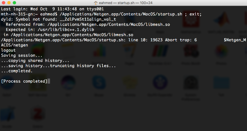

The latest nightly build still doesn’t work. Actually any release from September 3 and older works fine, but the latest ones (September 4 and later) do not work.
Attached is a terminal snapshot for the installation of the latest nightly build.
