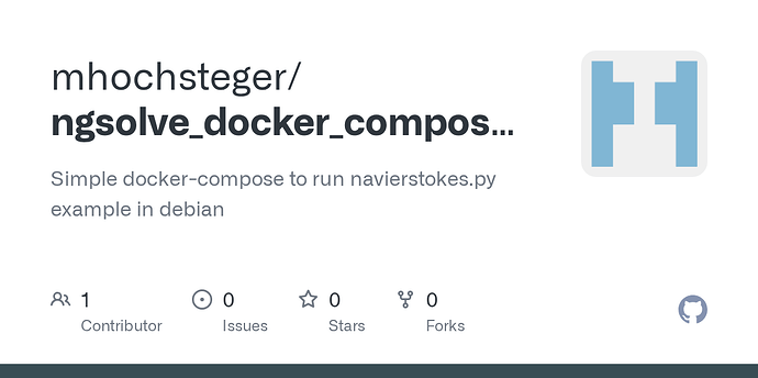

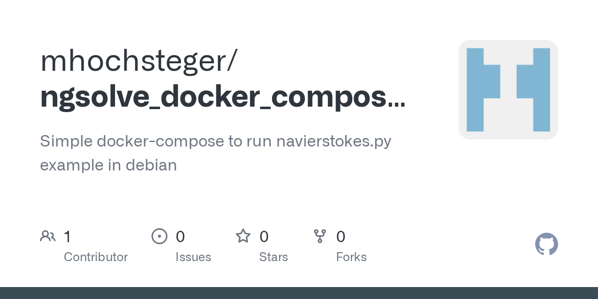

Thanks for the detailed bug report. I managed to reproduce your issue exactly as you stated ( happens only with OCC ). FYI: I used this docker build to trigger the bug (not using debian myself):
I will let you know, when I have an update/workaround/idea whats wrong here.
