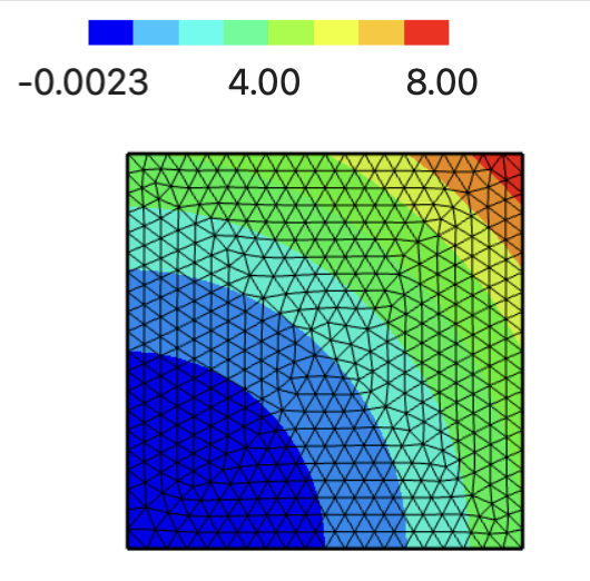

Hi, I was trying to implement Nitsche boundary penatly method on a deformed mesh and stumbled across what could be a bug.
An example for the Poisson equation is the following

It seems like some penalty terms ignore the deformation flag. Using mesh.SetDeformation(dX) before the assembly instead leads to the correct result.
