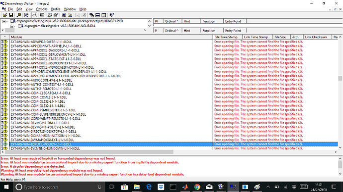

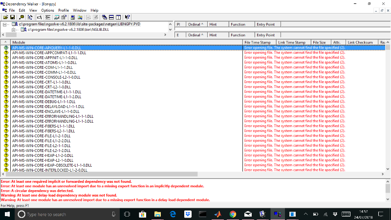

Thanks for this. I did it (I actually tried this before) and it tells me that I am missing DLLs of the form API-MS-…, EXT-MS-… and a couple of others which, from searching online, it looks like this is not an issue in Windows 10.
I will search more thoroughly - does the fact that I can run Netgen with the interface but not from the command line make a difference?

Hi Susana,
Some API-MS-… DLL files missing in the dependency walker are usual. I think that’s not the cause for your problem.

Could you also make a screenshot of the missing libraries in the dependency walker again?

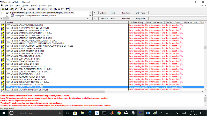

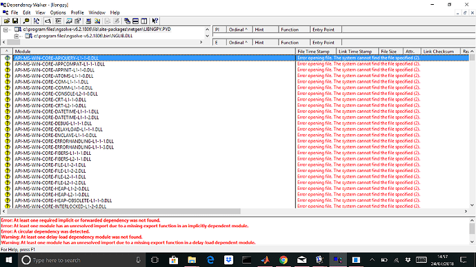

There are too many libraries missing to printscreen but I am attaching some examples:
API-MS-WIN-…
or
EXT-MS-…
The only ones not of this form are:
DEVICELOCKHELPERS.DLL
EMCLIENT.DLL
IESHIMS.DLL
and the message is the same.

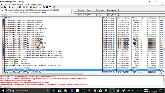

There are also some warnings:
Is it worth saving this as a .dwi file and sending it to you?

Indeed I see other possible issues on the last screenshot: Opencascade libraries are not loaded from the Netgen install dir but from a Matlab installation. Possibly that’s the cause of your problems. You could try removing “C:\Program Files\matlab\r2017a\bin\win64” from PATH (either user- or system-wide) and see if that helps.
